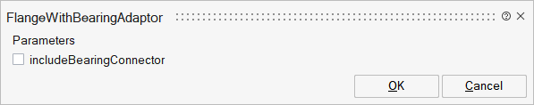

FlangeWithBearingAdaptor
Adaptor to allow direct connections to the sub-connectors of FlangeWithBearing
Mechanics/MultiBody/Interfaces
Adaptor object to make a more visible connection to the flange and frame subconnectors of a FlangeWithBearing connector.
mo_includeBearingConnector | includeBearingConnector | = true, if bearing frame connector is present, otherwise not present | Number | 0 |
flangeAndFrame | implicit | Compound connector consisting of 1-dim. rotational flange and 3-dim. frame mounting | input | 1 |
flange | implicit | 1-dim. rotational flange | output | 1 |
Port 3 | implicit | 3-dim. frame in which the 1-dim. shaft is mounted | input | mo_includeBearingConnector |
