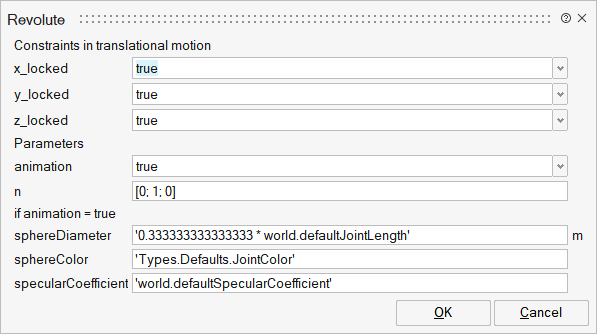

mo_x_locked | x_locked | = true: constraint force in x-direction, resolved in frame_a | Scalar | true |
mo_y_locked | y_locked | = true: constraint force in y-direction, resolved in frame_a | Scalar | true |
mo_z_locked | z_locked | = true: constraint force in z-direction, resolved in frame_a | Scalar | true |
mo_animation | animation | = true, if animation shall be enabled (show sphere) | Scalar | true |
mo_n | n | Axis of rotation resolved in frame_a (= same as in frame_b) | Vector of size 3 | |
mo_sphereDiameter | sphereDiameter | Diameter of sphere representing the spherical joint | Scalar | |
mo_sphereColor | sphereColor | Color of sphere representing the spherical joint | Vector of size 3 | |
mo_specularCoefficient | specularCoefficient | Reflection of ambient light (= 0: light is completely absorbed) | Scalar | |
mo_e | e | Unit vector in direction of rotation axis, resolved in frame_a (= same as in frame_b) | Vector of size 3 | |
mo_nnx_a | nnx_a | Arbitrary vector that is not aligned with rotation axis n | Vector of size 3 | |
mo_ey_a | ey_a | Unit vector orthogonal to axis n of revolute joint, resolved in frame_a | Vector of size 3 | |
mo_ex_a | ex_a | Unit vector orthogonal to axis n of revolute joint and to ey_a, resolved in frame_a | Vector of size 3 |
