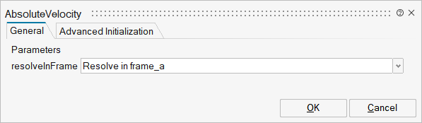

Via parameter resolveInFrame it is defined, in which frame the velocity vector is resolved:
| resolveInFrame = Types.ResolveInFrameA. | Meaning |
| world | Resolve vector in world frame |
| frame_a | Resolve vector in frame_a |
| frame_resolve | Resolve vector in frame_resolve |
If resolveInFrame = Types.ResolveInFrameA.frame_resolve, the conditional connector "frame_resolve" is enabled and v is resolved in the frame, to which frame_resolve is connected. Note, if this connector is enabled, it must be connected.

mo_resolveInFrame | resolveInFrame | Frame in which output vector v shall be resolved (world, frame_a, or frame_resolve) | Structure | |
mo_resolveInFrame/choice1 | Resolve in world frame | Number | 0 | |
mo_resolveInFrame/choice2 | Resolve in frame_a | Number | 0 | |
mo_resolveInFrame/choice3 | Resolve in frame_resolve (frame_resolve must be connected) | Number | 0 |

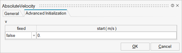

mo_v | v | v | Structure | |
mo_v/fixed | fixed | Cell of vectors of size 3 | true | |
mo_v/start | start | Cell of vectors of size 3 |
