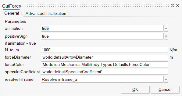

The cut-force acting between the two frames to which this model is connected, is determined and provided at the output signal connector force (= frame_a.f). If parameter positiveSign = false, the negative cut-force is provided (= frame_b.f).
Via parameter resolveInFrame it is defined, in which frame the force vector is resolved:
| resolveInFrame = Types.ResolveInFrameA. | Meaning |
| world | Resolve vector in world frame |
| frame_a | Resolve vector in frame_a |
| frame_resolve | Resolve vector in frame_resolve |
If resolveInFrame = Types.ResolveInFrameAB.frame_resolve, the conditional connector "frame_resolve" is enabled and output force is resolved in the frame, to which frame_resolve is connected. Note, if this connector is enabled, it must be connected.
In the following figure the animation of a CutForce sensor is shown. The dark blue coordinate system is frame_b, and the green arrow is the cut force acting at frame_b and with negative sign at frame_a.
mo_animation | animation | = true, if animation shall be enabled (show arrow) | Scalar | true |
mo_positiveSign | positiveSign | = true, if force with positive sign is returned (= frame_a.f), otherwise with negative sign (= frame_b.f) | Scalar | true |
mo_N_to_m | N_to_m | Force arrow scaling (length = force/N_to_m) | Scalar | |
mo_forceDiameter | forceDiameter | Diameter of force arrow | Scalar | |
mo_forceColor | forceColor | Color of force arrow | Vector of size 3 | |
mo_specularCoefficient | specularCoefficient | Reflection of ambient light (= 0: light is completely absorbed) | Scalar | |
mo_resolveInFrame | resolveInFrame | Frame in which output vector(s) is/are resolved (world, frame_a, or frame_resolve) | Structure | |
mo_resolveInFrame/choice1 | Resolve in world frame | Number | 0 | |
mo_resolveInFrame/choice2 | Resolve in frame_a | Number | 0 | |
mo_resolveInFrame/choice3 | Resolve in frame_resolve (frame_resolve must be connected) | Number | 0 |

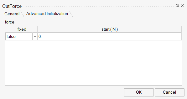

mo_force | force | force | Structure | |
mo_force/fixed | fixed | Cell of vectors of size 3 | true | |
mo_force/start | start | Cell of vectors of size 3 |
