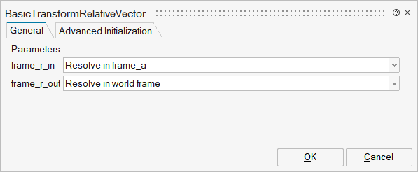

Via parameters frame_r_in and frame_r_out it is defined in which frame the position vector is resolved:
| resolveInFrame = Types.ResolveInFrameAB. | Meaning |
| world | Resolve vector in world frame |
| frame_a | Resolve vector in frame_a |
| frame_b | Resolve vector in frame_b |
| frame_resolve | Resolve vector in frame_resolve |
In this basic sensor model, the connector frame_resolve is always enabled and must be connected.
mo_frame_r_in | frame_r_in | Frame in which vector r_in is resolved (world, frame_a, frame_b, or frame_resolve) | Structure | |
mo_frame_r_in/choice1 | Resolve in world frame | Number | 0 | |
mo_frame_r_in/choice2 | Resolve in frame_a | Number | 0 | |
mo_frame_r_in/choice3 | Resolve in frame_b | Number | 0 | |
mo_frame_r_in/choice4 | Resolve in frame_resolve (frame_resolve must be connected) | Number | 0 | |
mo_frame_r_out | frame_r_out | Frame in which vector r_out (= r_in in other frame) is resolved (world, frame_a, frame_b, or frame_resolve) | Structure | |
mo_frame_r_out/choice1 | Resolve in world frame | Number | 0 | |
mo_frame_r_out/choice2 | Resolve in frame_a | Number | 0 | |
mo_frame_r_out/choice3 | Resolve in frame_b | Number | 0 | |
mo_frame_r_out/choice4 | Resolve in frame_resolve (frame_resolve must be connected) | Number | 0 |

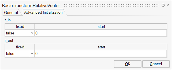

mo_r_in | r_in | r_in | Structure | |
mo_r_in/fixed | fixed | Cell of vectors of size 3 | true | |
mo_r_in/start | start | Cell of vectors of size 3 | ||
mo_r_out | r_out | r_out | Structure | |
mo_r_out/fixed | fixed | Cell of vectors of size 3 | true | |
mo_r_out/start | start | Cell of vectors of size 3 |
