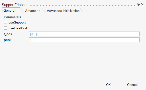

mo_useSupport | useSupport | = true, if support flange enabled, otherwise implicitly grounded | Number | 0 |
mo_f_pos | f_pos | [v, f] Positive sliding friction characteristic (v>=0) | Matrix of size Mx2 | |
mo_peak | peak | Peak for maximum friction force at w==0 (f0_max = peak*f_pos[1,2]) | Scalar | |

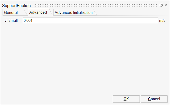

mo_v_small | v_small | Relative velocity near to zero (see model info text) | Scalar |

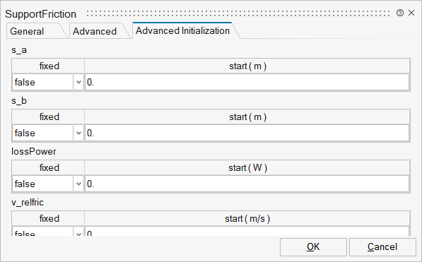

mo_lossPower | lossPower | lossPower | Structure | |
mo_lossPower/fixed | fixed | Cell of scalars | true | |
mo_lossPower/start | start | Cell of scalars | ||
mo_v_relfric | v_relfric | v_relfric | Structure | |
mo_v_relfric/fixed | fixed | Cell of scalars | true | |
mo_v_relfric/start | start | Cell of scalars | ||
mo_a_relfric | a_relfric | a_relfric | Structure | |
mo_a_relfric/fixed | fixed | Cell of scalars | true | |
mo_a_relfric/start | start | Cell of scalars | ||
mo_f0 | f0 | f0 | Structure | |
mo_f0/fixed | fixed | Cell of scalars | true | |
mo_f0/start | start | Cell of scalars | ||
mo_f0_max | f0_max | f0_max | Structure | |
mo_f0_max/fixed | fixed | Cell of scalars | true | |
mo_f0_max/start | start | Cell of scalars | ||
mo_free | free | free | Structure | |
mo_free/fixed | fixed | Cell of scalars | true | |
mo_free/start | start | Cell of scalars | ||
mo_sa | sa | sa | Structure | |
mo_sa/fixed | fixed | Cell of scalars | true | |
mo_sa/start | start | Cell of scalars | ||
mo_startForward | startForward | startForward | Structure | |
mo_startForward/fixed | fixed | Cell of scalars | true | |
mo_startForward/start | start | Cell of scalars | ||
mo_startBackward | startBackward | startBackward | Structure | |
mo_startBackward/fixed | fixed | Cell of scalars | true | |
mo_startBackward/start | start | Cell of scalars | ||
mo_locked | locked | locked | Structure | |
mo_locked/fixed | fixed | Cell of scalars | true | |
mo_locked/start | start | Cell of scalars | ||
mo_mode | mode | mode | Structure | |
mo_mode/fixed | fixed | Cell of scalars | true | |
mo_mode/start | start | Cell of scalars | ||
mo_s | s | s | Structure | |
mo_s/fixed | fixed | Cell of scalars | true | |
mo_s/start | start | Cell of scalars | ||
mo_f | f | f | Structure | |
mo_f/fixed | fixed | Cell of scalars | true | |
mo_f/start | start | Cell of scalars | ||
mo_v | v | v | Structure | |
mo_v/fixed | fixed | Cell of scalars | true | |
mo_v/start | start | Cell of scalars | ||
mo_a | a | a | Structure | |
mo_a/fixed | fixed | Cell of scalars | true | |
mo_a/start | start | Cell of scalars |
