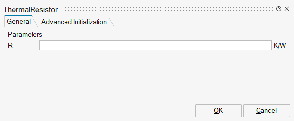

mo_R | R | Constant thermal resistance of material | Scalar |

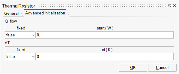

mo_Q_flow | Q_flow | Q_flow | Structure | |
mo_Q_flow/fixed | fixed | Cell of scalars | true | |
mo_Q_flow/start | start | Cell of scalars | ||
mo_dT | dT | dT | Structure | |
mo_dT/fixed | fixed | Cell of scalars | true | |
mo_dT/start | start | Cell of scalars |
