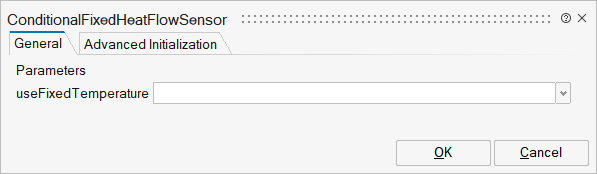

If useFixedTemperature = false, this sensor acts just as a normal HeatFlowSensor.
If useFixedTemperature = true, it is assumed that the connections to both heatPorts of this sensor are conditionally removed; in this case, the measured Q_flow is reported = 0 automatically. To avoid a singular equation system, the temperature of the sensor is set to 293.15 K.
mo_useFixedTemperature | useFixedTemperature | Fixed Temperature if true | Scalar | true |

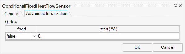

mo_Q_flow | Q_flow | Q_flow | Structure | |
mo_Q_flow/fixed | fixed | Cell of scalars | true | |
mo_Q_flow/start | start | Cell of scalars |
