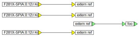

The execOrder block executes its inputs in top-down order as well. To read hardware registers in a specific order, you can wire the Extern Read block to an execOrder block to control when each Extern Read input is executed. For example, suppose you have the following configuration:

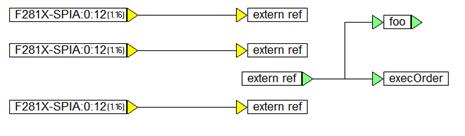

It is ambiguous when the Extern Read block is executed. To enforce the order of execution, wire the Extern Read block into an execOrder block like so:
In this configuration, the Extern Read block will execute third.
