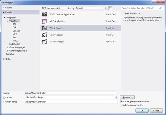

3. In the left windowpane, select Visual C++. In the right windowpane, select Win32 Project. Then enter the project name and location in the text boxes at the bottom of the window. We recommend activating Create directory for solution. When you do so, the Solution Name defaults to the project name.
4. Press OK.

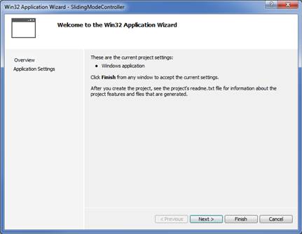

The Win32 Application Wizard starts.
5. Press Next.

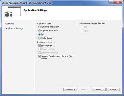

The Application Setting window appears.
6. Do the following:
•Under Application Types, select DLL.
•Under Additional Options, select Empty Project.
•Click Finish.

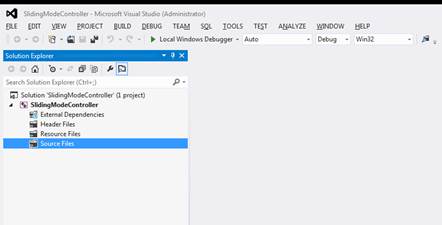

The Solution Explorer window appears.
7. Before proceeding, open Windows Explorer and copy the custom C or Embed-generated C file to your newly-created project location.
8. Go back to the Solution Explorer window.

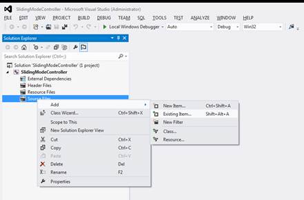

9. Right-click Source Files; then click Add > Existing Item.
10. Select your custom or Embed-generated C file and press Add.

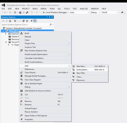

11. Right-click the Project Name and select Add > Existing Item.
12. Insert the following:
