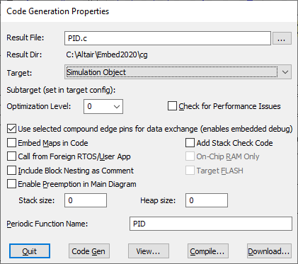

4. Choose Tools > Code Gen.
The Result File box displays compound-block-name.C, where compound-block-name is the name of selected compound block in the current diagram.
If you are creating more than one simulation object from a single Embed diagram, give each simulation object a unique name.
5. The Result Dir box indicates where the simulation object will be stored. Click … to change the location.
6. The Target box contains the target platform for code generation. Choose Simulation Object, if it is not already selected.
7. Activate Use selected compound edge pins for data exchange; then choose from the following parameters:

8. Click Compile.
9. Embed opens a text window in which it displays simulation object creation. When the simulation object has been generated, press any key to return to the Code Generation Properties dialog.
10. Click Done.
