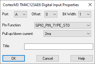

Description: The Digital Input block receives digital data.
The Digital Input block is useful for hardware-in-the-loop simulation.
Bit Width: Specifies the bit width.
Offset: Specifies the offset.
Pin Function: Specifies the pin function.
Port: Specifies the port.
Pull up/down current: Lets you specify the pin draw current in ON or OFF mode. This parameter is typically used for communication protocols, like I2C. This parameter is available only for devices that support it.
Title: Indicates the channel title.
