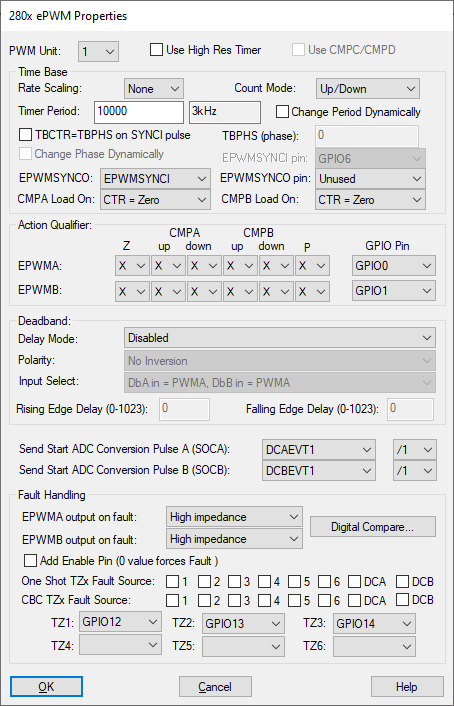

PWM Unit: Specifies the unit to be configured.
Send Start ADC Conversion Pulse A: Indicates whether the ePWM unit should send a SOC A (start conversion on Pulse A) to the ADC unit.
Send Start ADC Conversion Pulse B: Indicates whether the ePWM unit should send a SOC B (start conversion on Pulse B) to the ADC unit.
Time Base
Change Period Dynamically: Produces an external input pin (%Perdiod (1.16)) that lets you specify a fractional value for the period on-the-fly. The external value will be multiplied by the period and assigned to the TBPRD (period) register. This allows you to dynamically modulate the PWM-based frequency.
Change Phase Dynamically: Produces an external input pin (%Phase (1.16)) that lets you specify a fractional value for the phase on-the-fly. The external value will be multiplied by the phase and assigned to the TBPHS (phase) register. This allows you to dynamically modulate the PWM-based frequency. To activate Change Phase Dynamically, you must also activate TBCTR=TBPHS on SYNCI pulse.
CMPA/B Load On: Selects condition to cause the CMPA/B register to be loaded.
Count Mode: Determines the counting mode. Typically, Up/Down is selected.
EPWMSYNCI Pin: Indicates the hardware pin supplying the EPWMSYNCI input pulse for unit 1.
EPWMSYNCO: Indicates the synchronizing signal sent from this unit to unit n+1.
Rate Scaling: Scales the timer source to a slower rate.
TBCTR=TBPHS on SYNCI pulse: The counter for this unit is assigned the value of the TBPHS (phase) register on occurrence of a SYNCI input pulse.
TBPHS (phase): Specifies an offset value added to the time-based counter on occurrence of the SYNCI input pulse.
Timer Period: Specifies the number of PWM clock ticks for one complete PWM waveform. The frequency of the PWM signal is determined as follows:
System-Clock-Frequency/Timer-Frequency = PWM-Frequency
For example, 150 MHz/150 = 1 MHz.
Use CMPC/CMPD: Enables compare C and compare D inputs that can be used to send synchronization pulses to the ADC or DMA unit.
Use High Res Timer: Enables the use of a high-resolution timer.
