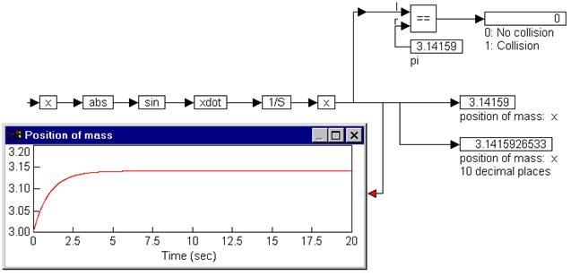

In a collision detection problem, if position x of a mass in motion is equal to π, then a collision is assumed to have occurred with an immovable wall that is located at x = π. Furthermore, the position of the mass is assumed to be given by the solution of the following first order differential equation:
The initial condition is assumed to be x(0) = 3.0. It is tempting to realize this system as:
From the result shown in the plot block, at around t = 7s, the mass arrives at the boundary located at π. However, the collision detection logic, using an == block that compares x with a constant value of π, never detects the collision. This is because the final mass position, as obtained from the output of the integrator, is 3.141592653, which is not equal to 3.14159.
It is clear from the plot block, that for all practical purposes, the mass collided with the wall around t = 7s. To capture this reality in the simulation, convert the Boolean equality comparison:

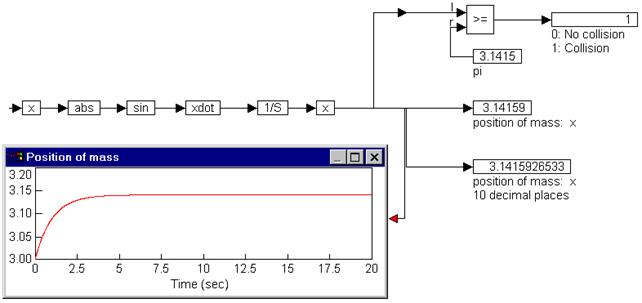

If x = 3.14159
Then to a Boolean inequality comparison:
If x ≥ 3.1415
Then after reducing the const block to four decimal places with no round-off, the system can be realized as:
Except for replacing the == block with the >= block, this diagram is like the previous one. In this case, the collision detection logic detects a collision around t = 8s. Obviously, the time at which the collision is detected depends on the number of decimal places retained for the π approximation.
