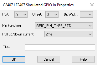

Description: The values presented to the input of the GPIO In block will appear on the output of the actual GPIO In block during a simulation.
Bit Width: Specifies the number of contiguous bits to read in.
Offset: Specifies the offset into the digital port register.
Pin Function: Specifies the pin function.
Port: Specifies the digital register.
Pull Up/Down Current: Lets the specified pin draw current in ON or OFF mode. It is typically used for communication protocols, like I2C.
Title: Indicates the channel title.
