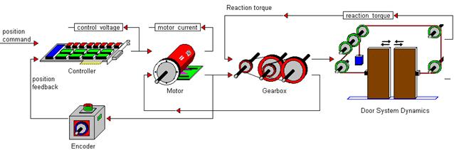

A simplified elevator door control system—shown below—consists of a DC motor driving a gearbox that in turn manipulates the door position through a series of pulleys. The controller accepts open and close commands as inputs, and controls the magnitude and polarity of voltage that is applied to the DC motor. An encoder provides motor rotor shaft position feedback to the control system.
