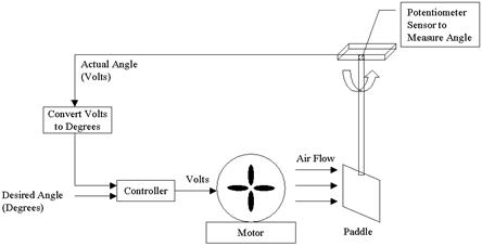

The system comprises an electrical motor connected to a small propeller that blows air on a paddle. The paddle is moved at an angle from the vertical. The control problem is to adjust the speed of the motor by varying its input voltage to maintain the paddle at a user-defined angle from the vertical. The system can be schematically represented as shown below.

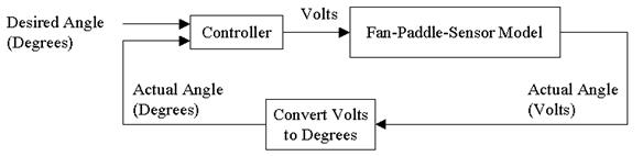

For the prototyping process, the fan-paddle-sensor subsystem can be collapsed into a single model, as shown below.
