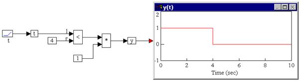

1. Simple if-then-else construct
Consider a variable y such that:
If t < 4 then y = 1; else y = 0
Assume that t is simulation time. This system can be realized as:
By multiplying a constant value 1 with the output of the < block, y is guaranteed to assume a value of 0 until the inequality is true. When the inequality is true, y assumes a value equal to the output of the * block.
