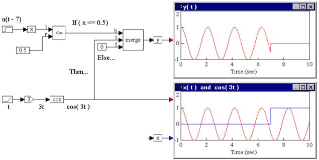

1.  Simple if-then-else construct
Consider a variable y such that:
If x ≤ 0.5 then y = cos(3t); else y = 0
where t is simulation time. Let x be a unit step delayed by 7s, represented as u(- 7). This system can be realized as shown below.
Until the onset of the step input at t = 7s, the Boolean inequality x 0.5 evaluates to true, and y takes on a value of cos(3t). At  t = 7s, the Boolean inequality evaluates to false and remains false for the duration of the simulation. Consequently, from this point onwards, y takes on the value of 0. The lower plot block monitors the outputs of the cos and variable x blocks.
