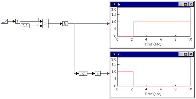

Consider a variable c such that:
or in other words, c = not(b). Furthermore, assume that b is true if t > 2.2; else b is false, where t is the simulation time. This system can be realized as shown below.
From the outputs obtained in the two plot blocks, b, given by the output of the > block is true only when t is > 2.2. This requires that c, which is defined to be not (b), be true only the range t < 2.2, as obtained in the bottom plot block.
