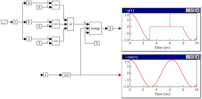

1. Computation of three inputs
Consider a variable y such that:
If a ≥ 8 or b = 6 or c ≤ 3, then y = cos(t); else y = 0
where t is simulation time. Furthermore, let t be the input to all three parameters a, b, and c. This system can be realized as shown below.
During simulation, the or block evaluates to false in the interval t = (3,8), except for the instant t = 6. In this case, the variable y takes on the value of 0. The output of or evaluates to true in the remaining parts of the simulation, and as a result, y takes on the value of cos(t) in these periods, including the instant t = 6.
