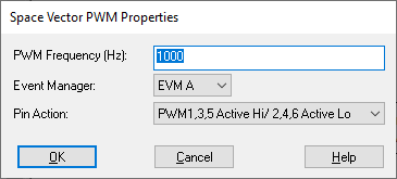

Event Manager: For the 2407, you can select EVM B, which is hardwired to the GP timer 3.
Pin Action: Indicates Active Hi or Low. If pin 1 is active high, the deadband unit will cause pin 2 to delay switching high for the deadband interval when pin 1 switches to low. If pin 1 is active low, the deadband unit will cause pin 2 to delay switching low for the deadband interval when pin 1 switches to high.
PWM Frequency: Indicates the base modulation frequency of the PWM. Note that this block is hardwired to GP timer 1 and drives pins PWM 1 - 6.
