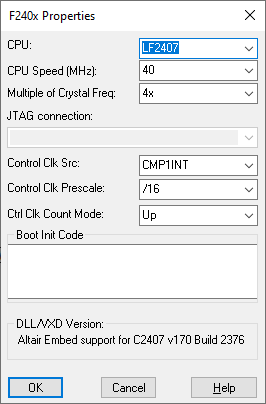

Using the F240X Config
Target Category: F240X
The F240X Config block lets you configure settings for the F240X.
Boot Init Code: Specifies user C code to initialize the chip.
Control Clk Prescale: Chooses the prescale factor for the PWM based control clock. If the PWM is also used as an output peripheral, this setting must match the setting of the PWM block in the diagram.
Control Clk Src: Chooses periodic sampling interrupt source for the main control loop in Embed.
CPU: For some targets, there is a family of CPU types. It is important to select the exact CPU type for the specified target.
CPU Speed: Indicates the speed of the CPU.
Ctrl Clk Count Mode: Chooses the count mode for the PWM based control clock. If the PWM is also used as an output peripheral, this setting must match the setting of the PWM block in the diagram.
JTAG Connection: Indicates the JTAG driver to be used for HotLink communication.
Multiple of Crystal Freq: Indicates the multiple of crystal frequency.
