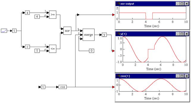

Consider a variable y such that:
If a ≥ 4 or c ≤ 5, then y = cos(t); else y = 0. Also, if a ≥ 4 and c ≤ 5, y = 0
where t is simulation time. Furthermore, let t be the input to parameters a and c. This system can be realized as shown below.
As shown in the two plot blocks, the output of the xor block evaluates to false in the interval t = (4, 5), since both the inputs to the xor block are true in this interval. Consequently, y takes on the value of 0. The output of xor evaluates to true in the remaining parts of the simulation, and as a result, y takes on the value of cos(t) in these periods.
