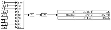

3. Computation of 1/X of a matrix
Consider the equation:
Z = 1/ Y
where
This is realized as:
When the simulation runs, the 1/X block performs an element-by-element inverse operation on the incoming matrix.
