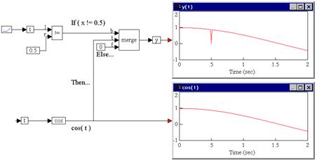

1. Comparing constants
Consider a variable y such that:
If t ≠ 0.5 then y = cos(t); else y = 0
where t is simulation time realized as:
Until the value of t reaches 0.5, the Boolean inequality t 0.5 evaluates to true, and y takes on a value of cos(t). At t = 0.5 sec, the Boolean inequality evaluates to false, and at the very next time step, returns to true, and remains true for the duration of the simulation. Consequently, at the moment t = 0.5 sec, y takes on the value of 0, and at every other point, y is equal to cos(t).
