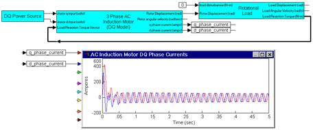

Diagram name: ACIM DQ Model
Location: Examples > eMotors (Legacy) > AC Induction
A DQ frame voltage source is created using a three-phase source, and Clarke and Park’s transforms (see example under Park Transform). Rotor displacement is connected to the Rotational Load block. Reaction torques are fed back to the motor model. DQ transient currents are observed by plotting signals from the output wires provided on the motor model.
