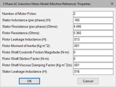

Number of Motor Poles: Indicates the number of motor pole pairs.
Rotor Leakage Inductance: Indicates the specified rotor leakage inductance.
Rotor Moment of Inertia: Indicates the moment of inertia of the rotor with respect to the axis of rotation.
Rotor Resistance: Indicates the rotor winding resistance.
Rotor Shaft Coulomb Friction Magnitude: Allows specification of constant directional dissipative force (Coulomb model).
Rotor Shaft Stiction Factor: Allows specification of a stiction force value or break-away torque. This parameter is normally not specified by the motor manufacturer, but can be obtained experimentally.
Rotor Shaft Viscous Damping Factor: Indicates the factor that linearly relates viscous damping force to angular velocity. This parameter is normally not specified by the motor manufacturer, but can be determined experimentally.
Stator Inductance (per phase): Indicates the stator per phase inductance.
Stator Leakage Inductance: Indicates the specified stator leakage inductance.
Stator Resistance (per phase): Indicates the stator per phase resistance.

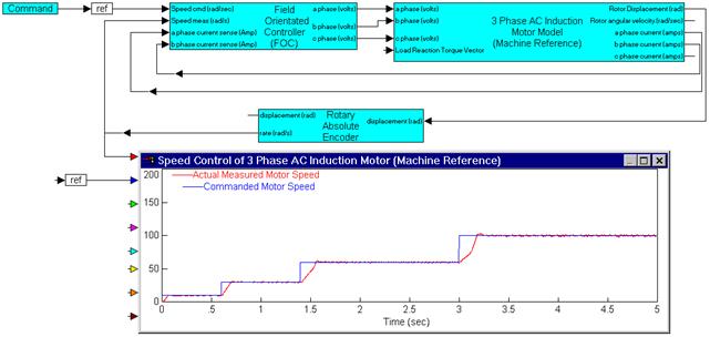

The following simulation example illustrates the application of the Field Orientated Controller-sim block in controlling speed of a three-phase AC induction motor using a rotary encoder for feedback. Current is sensed using the motor model output currents. The command profile shows stable and accurate control of speed over a wide range of speeds.
