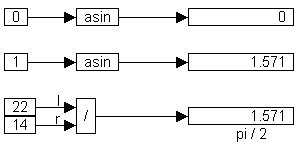

1. Computation of sin-1(1) = π/2; sin-1(0) = 0
This equation is realized as:
Two const blocks, set to 0 and 1, are fed to the asin blocks. For comparison, the constant value of π/2 is generated by feeding two const blocks, set to 22 and 14, into the / block. From the results obtained, the asin blocks yield correct values for the angles.
