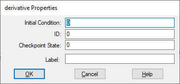

Checkpoint State: Contains the value of the derivative at the checkpoint. If you have not checkpointed your simulation in the System Properties dialog, the value is 0. You can enter a value in hexadecimal notation or as a C expression.
Initial Condition: Indicates the initial value of the derivative. The default is 0. You can enter a value in hexadecimal notation or as a C expression.
