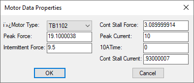

Description: When you attach a data table to a dialogTable block, Embed arranges and presents the information from the data lists in the dialogTable dialog. For example, the dialog below lists parametric data for a TB1102 motor:
Select a motor in Motor Type. Embed updates the dialog with data corresponding to the newly-selected motor.

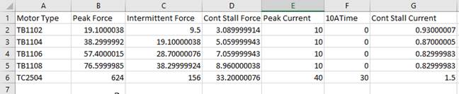

The following illustration shows an Excel data table for five different motors.
The first field name in the header record—the item identifier—is Motor Types. The different types of motors are listed beneath the Motor Types column heading. The remaining field names in the header record are column headings for motor information. For example, the peak force for each motor type is listed in the column of cells labeled Peak Force. Each of the remaining rows of cells, the data records, contains a set of information for a specific motor. When you attach the data table to a dialogTable block, the field names in the header record are listed as parameter names in the dialog.

The Properties dialog appears, like the one shown below:
The field names in the header record are the parameter names in the dialog. The information from the first data record is displayed in the text boxes.
2. To display another data record, click the DOWN ARROW for the first parameter—in this case, Motor Type—and select the item whose data record you want displayed. Embed updates the information in the remaining text boxes accordingly.
