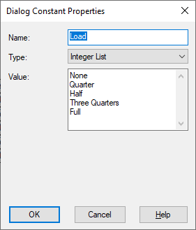

1. Under Blocks > Signal Producers, drag a dialogConstant block into the workspace.
2. Right-click the dialogConstant block.
3. In the Dialog Constant Properties dialog, enter a name (Load), select the data type (Integer List), and enter the five values.
The output of the dialogConstant block will be the ordinal value of the selected item in the list, where the topmost item has a value 0.

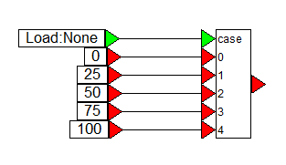

4. To transform the list index value to other values, wire the dialogConstant and five const blocks—with values set to 0, 25, 50, 75, and 100—to a case block:

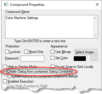

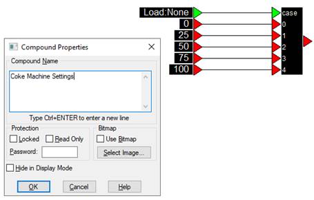

5. Encapsulate the dialogConstant block and associated const and case blocks in a compound block.
6. CTRL+right-click over the Coke Machine Settings and select Create Dialog from Contained Dialog Constants.
When you right-click Coke Machine Settings, the newly-created Auto Dialog containing all dialogConstant blocks appears.

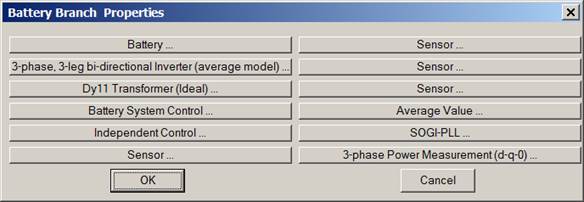

3. Auto Dialog box with buttons

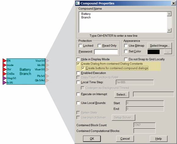

You can logically organize dialogConstant blocks within a single Auto Dialog box to make them more easily accessible. This is accomplished in the compound block dialog using the Create Dialog From Contained Dialog Constants and the Create Buttons For Contained Compound Dialogs parameters.

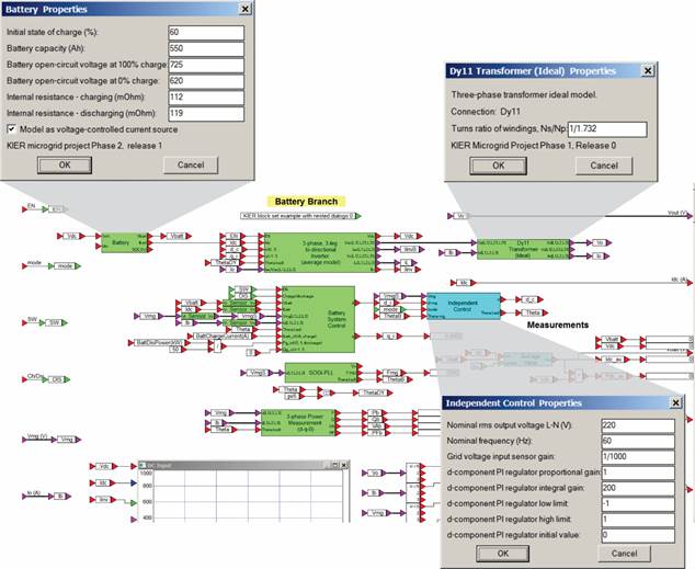

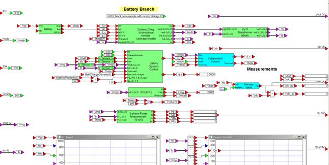

For example, below is a complex battery subsystem:
Each of the green and blue blocks is a compound block with an Auto Dialog associated with it. To access the Auto Dialog for a given compound block, right-click it. The figure below shows several of the Auto Dialogs that are accessible:
To make it easier to access each Auto Dialog, you can encapsulate the entire Battery Branch subsystem in a compound block and configure the compound block to create a single Auto Dialog that provides access to each of the nested Auto Dialogs.
When you click the Battery Branch compound block, the following Auto Dialog appears:
You now have access to each of the nested Auto Dialogs by simply clicking the corresponding button in the Battery Branch custom dialog.
