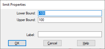

Lower Bound: Indicates the lowest value that the output signal can attain. The default is -100. You can enter a value in hexadecimal notation or as a C expression.
Upper Bound: Indicates the highest value that the output signal can attain. You can enter a value in hexadecimal notation or as a C expression. The default is 100.

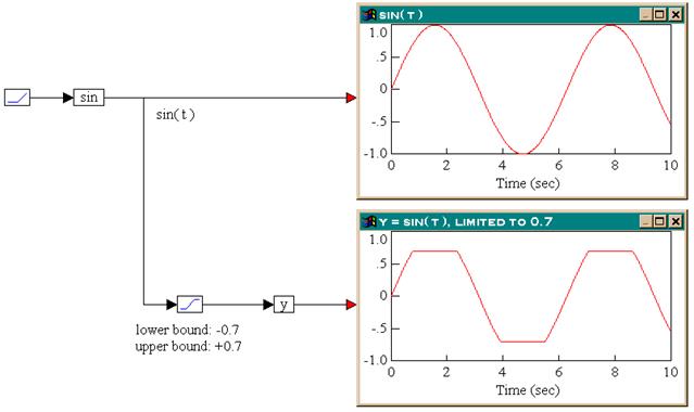

1. Simulation of saturation
Consider a variable y such that:
Furthermore, assume that y reaches saturation at +0.7 and -0.7, as shown below.
From the results in the two plot blocks, the output of the limit block is identical to the input, when the input is within the bounds (-0.7 to +0.7). When the input is out of these bounds, the output is limited to the upper or lower bound values.
