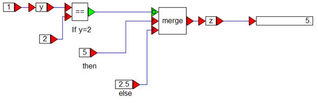

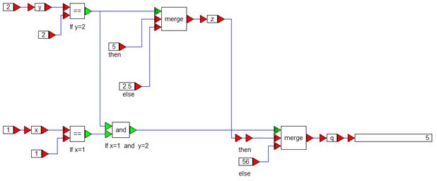

Description: The merge block expects a Boolean signal on x1. If the signal on x1 is floating point, it is automatically truncated to integer. The block output is the value presented on x2 if x1 is nonzero; otherwise, the output is x3. The letters b, t, and f on the input connectors indicate Boolean, True, and False.
The merge block is particularly well-suited for performing if-then-else decisions.
1. Simple If-Then-Else using merge block
2. Cascading If-Then-Else using merges
