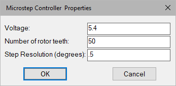

Number of Rotor Teeth: Indicates the physical number of teeth in the rotor.
Step Resolution: Defines the control resolution.
Voltage: Defines the RMS voltage level of the phase voltages through one cycle of motor rotation.
