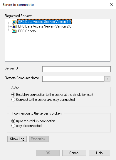

Action
Connect to the server and stay connected: Connects to the specified OPC server immediately. In this case, all server items will be available for browsing.
Establish connection to the server at the simulation start: Connects to the specified OPC server when the model is running.
If connection to the server is broken
Stay disconnected: Does not try to reconnect to the specified OPC server.
Try to reestablish connection: Tries to reconnect to the specified OPC server.
Properties: Shows the OPC server properties. Note that the properties can be viewed only if a connection to the server is established. Properties may vary from server to server.
Registered Servers: Lists the OPC servers registered on the computer.
Remote Computer Name: Specifies the name of the computer where the OPC server is (or will be) running. To choose a server, click the > button to navigate across the network. Leave this field blank blank if the OPC server is local. To connect via an alias, type $<alias-name>. If you are planning to deploy your distributed model in another network, you will likely need different computer names. To make the distributed model portable, you can create path aliases with Edit > Preferences > Path Aliases. You can use an alias as a substitute for a real computer name. To expand the alias, prefix its name with a dollar sign ($).
Server ID: Specifies the name of the OPC server to which to connect.
Show Log: Views log events.
