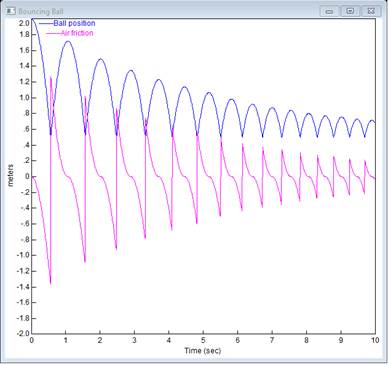

Basic time domain plots: When you wire a plot block into your diagram and run a simulation, the simulation data is initially presented in time domain. All the signals are plotted on the y-axis; the x-axis represents time. As data points arrive to be plotted, plot bounds are dynamically re-scaled and data points are automatically connected with line segments.
Code generation for plots: If you have a version of Embed that lets you generate code, plot blocks are ignored during code generation.
In the above plot, ball position and air friction are displayed as functions of time. The peak ball position follows an exponential decay, governed by air viscosity. The signals are distinguished by line patterns, a feature the plot block automatically performs when displaying or printing on monochrome devices. To make the plot more meaningful, signal labels and a title were also added.

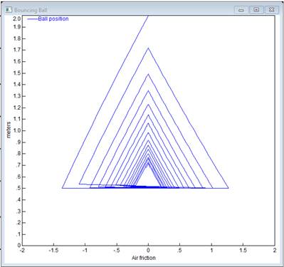

XY plots: In an XY plot, you use one input signal to represent X coordinate generation. As time advances, the remaining input signals are plotted relative to the x-axis signal. To create XY plots, use the XY Plot and X-Axis parameters in the Options dialog.
In the XY plot above, ball position is plotted against air friction. At time 0, the ball position is at 2 and air friction is at 0. Over the course of the simulation, the ball position moves counter-clockwise, following a three-sided decaying cycle.
