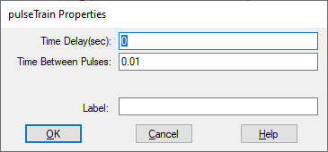

Time Between Pulses: Specifies the time between pulses. This is useful for clocking delays and sampleholds. The default is 0.01 sec. You can also enter a value in hexadecimal notation or as a C expression.
Time Delay (sec): Specifies how long to delay before calculating the value of the output signal. The default is 0 sec. If you try to implement a time delay that is a fraction of the simulation time step, the result is undefined. You can also enter a value in hexadecimal notation or as a C expression.
