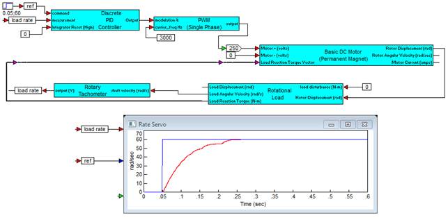

Description: The PWM-Single Phase block provides a pulse width modulated signal based on the input carrier frequency and % modulation.
Diagram name: PWM Single Phase
Location: Examples > eDrives > eMotors (Legacy) > Brush DC
In this example, the PID Controller (Digital) block is configured as PI and saturation limits are set for 0 – 100 for anti-windup control with the PWM logic. A modulation frequency is chosen at 3000 Hz, and the gain of 250 represents voltage switching at 250 V, controlled by the PWM. Velocity is measured from the load using a tachometer and fed back to the PI compensator.
