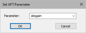

Description: The Set AFT Parameter block lets you choose which parameter to set.
Parameter: Select from the following:
