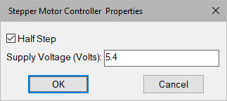

Half Step: When this checkbox is checked, the controller issues pulse sequences that step the motor in half step increments. When this checkbox is not checked, the controller issues full step increments.
Supply Voltage: Defines the voltage level of phase a and b pulses.

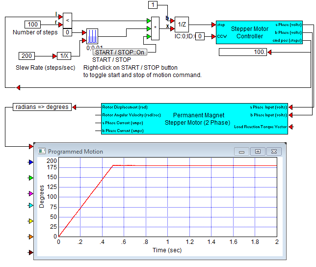

This example illustrates a typical application where a processor commands a step motor to increment to a specified step count at a specified slew rate.
Here the counter (cmd pos) output is used to compare against the set value of 100 steps. When the counter reaches the 100th step, the conditional < block output becomes zero. This closes the gate (multiplier block) for any further pulses issued by the pulseTrain block. The Time Between Pulses parameter for the pulseTrain block determines slew rate, and the operation is executed manually by clicking the Start button. The unitDelay block, used after the multiplier, allows perfect matching of counter to targeted step position, as well as preventing an algebraic loop. In this example, the stepper motor was specified having 50 rotor teeth making the full step 1.8o, and the controller was set for half stepping (0.9 o) Thus total angular displacement is 90o.
The advantage of open-loop control, as shown by this example, is that it is inexpensive; that is, it does not require sensors for feedback. The disadvantage is that positioning errors can occur if external shaft torque exceeds designed limits, causing the motor to lose steps. Open-loop systems may sometimes require periodic homing maneuvers that check actual shaft position against hard stops, limit switches, or sensors. Such systems and devices can also be simulated using Embed blocks.
