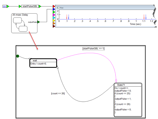

Triggering a transition with a guard
You can trigger a transition using a guard global variable defined in a diagram outside of the state chart.  For example, suppose you define a global binary variable startPulseGBL in your diagram. Within your state chart, you can use the variable to cause a transition with the guard statement [startPulseGBL]. This principle is used to delay a unit pulse signal by 25 msec:
SNAGHTML7fc9a55
