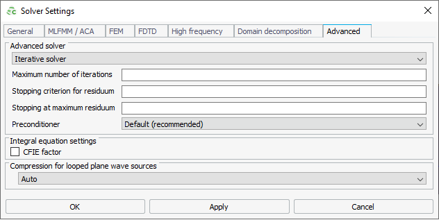

The number in brackets corresponds to the value of the I3 field at the CG
card in the model .pre file.
On the Solve/Run tab, in the
Solution Settings group, click the Solver Settings icon. On the Solver Settings dialog, click the
Advanced tab.
Figure 1. The Solver Settings dialog (Advanced
tab).
