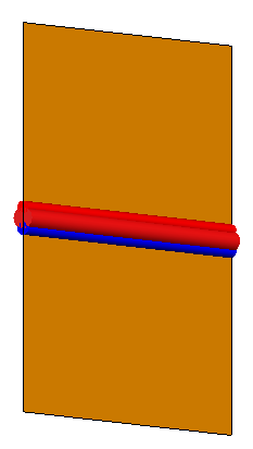

Apply an edge port to an edge between two sets of faces.
Faces referenced in the port definition must belong to the same part for a valid port definition.
Note: An edge port can be applied to a single UTD
face, but the faces on the other side of the defined port must be standard MoM faces.
Figure 1. The edge port in the 3D view. The side of the positive faces is indicated with a red cylinder and the negative faces with a blue cylinder.
