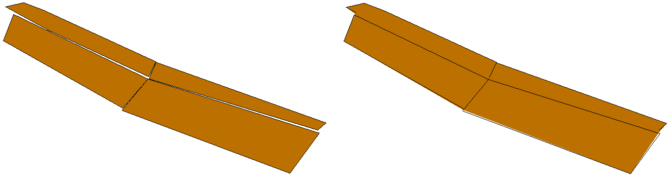

Figure 1. A part with several faults where the edges and vertices do not align (left) and after the
Repair and sew faces tool was used on the model (right).

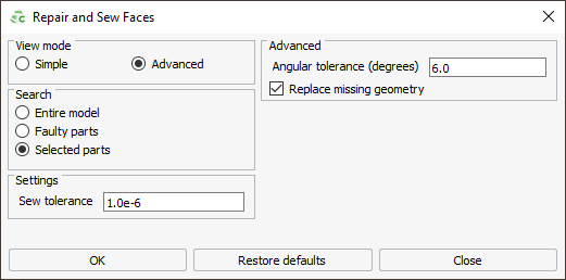

Figure 3. The Repair and Sew Faces dialog, Advanced
tab.
Sew tolerance
The supplied tolerance is used as the tolerance when sewing the sheets.
Advanced settings
Angular tolerance (degrees)
The tangent change angle in degrees above which G1discontinuities will be removed by
splitting rather than smoothing. (A surface can be composed of several NURBS surfaces or
“patches”. These patches should be fitted together in a way that the boundaries
are invisible. This is mathematically expressed by the concept of geometric continuity.
One of the options to establish geometric continuity is by means of Tangential
continuity (G1).It requires the end vectors of two curves or surfaces to be parallel
which eliminates sharp edges).
Replace missing geometry
The tool attempts to generate surface geometry for faces that will cap holes in the
resulting body. If the resultant body has closed circuits of laminar edges that appear to
bound a missing face, the tool attempts to generate a surface to span the gap (bounded by the
edges) and make a capping face from it.
