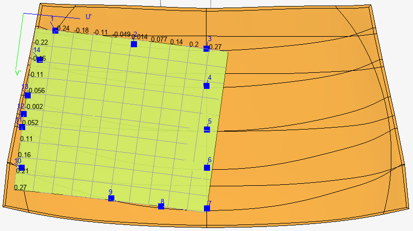

Specify the outline of the constrained surface.
Use point-entry to add points to the table by snapping to points on the
windscreen outline.
Table 1. Creating a constrained surface.
A blue square indicates a point added to the table. A red square indicates the current selected point in the table. Its number corresponds to its location in the table.The preview of the constrained surface is indicated in green.Note: The windscreen was offset slightly away from the camera to improve rendering.
If the windscreen is symmetric, you only need to specify points on half of the windscreen.

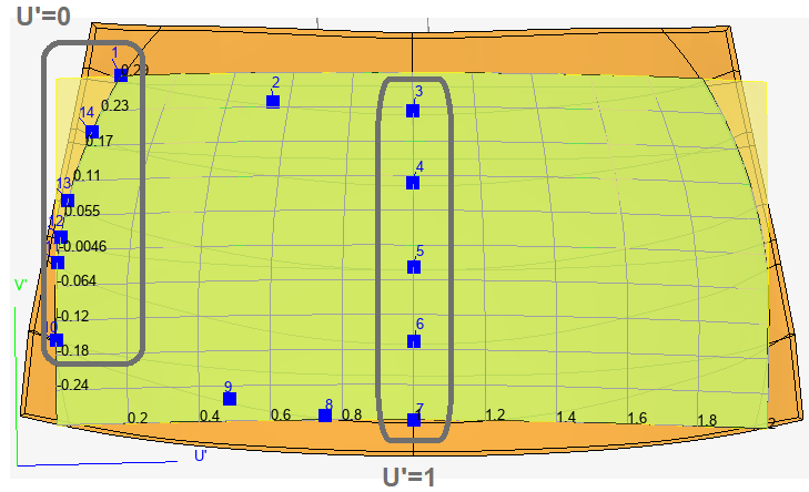

For this example, the Constant surface parameter at plane is specified as U′=1.
Points 3, 4, 5, 6 and 7 on the symmetry plane are set to U′=1.
Define the U′ values for the points to control the left and right grid lines.
Start at a corner point on and enter a U′ value. Repeat for remaining points on
the left grid line and right grid line.
Table 3. Setting the constant U' parameters for the constrained surface.
Number U′ V′ 3 1 4 1 5 1 6 1 7 1 1 0 14 0 13 0 12 0 11 0 10 0 For this example, corner point 1 and points 14, 13, 12, 11 and 10 are set to U′=0.Points 3, 4, 5, 6 and 7 were defined in Step 5 as it is located on the symmetry plane.

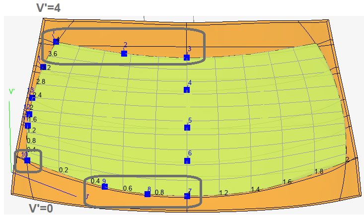

Define the V′ values for the points to control the top and bottom grid lines.
Start at a corner point and enter a V′ value. Repeat for the remaining points on the top grid line and bottom grid line.Table 4. Setting the constant V' parameters for the constrained surface.
Number U′ V′ 10 0 9 0 8 0 7 1 0 1 0 4 2 4 3 4 For this example, corner point points 10, 9, 8 and 7 are set to V′=0.Points 1, 2 and 3 are set to V′=4.

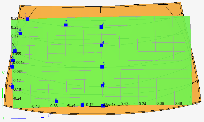

[Optional] Add additional internal points to ensure the internal grid lines
follow the imported guidelines.
For this example, points, 15, 16 and 17 were added.
Table 5. Setting optional additional internal points for the constrained surface.
Number U′ V′ 11 0 1 15 1 13 0 2 16 2 17 3 14 0 3 - Click Create to create the constrained surface and to close the dialog.
