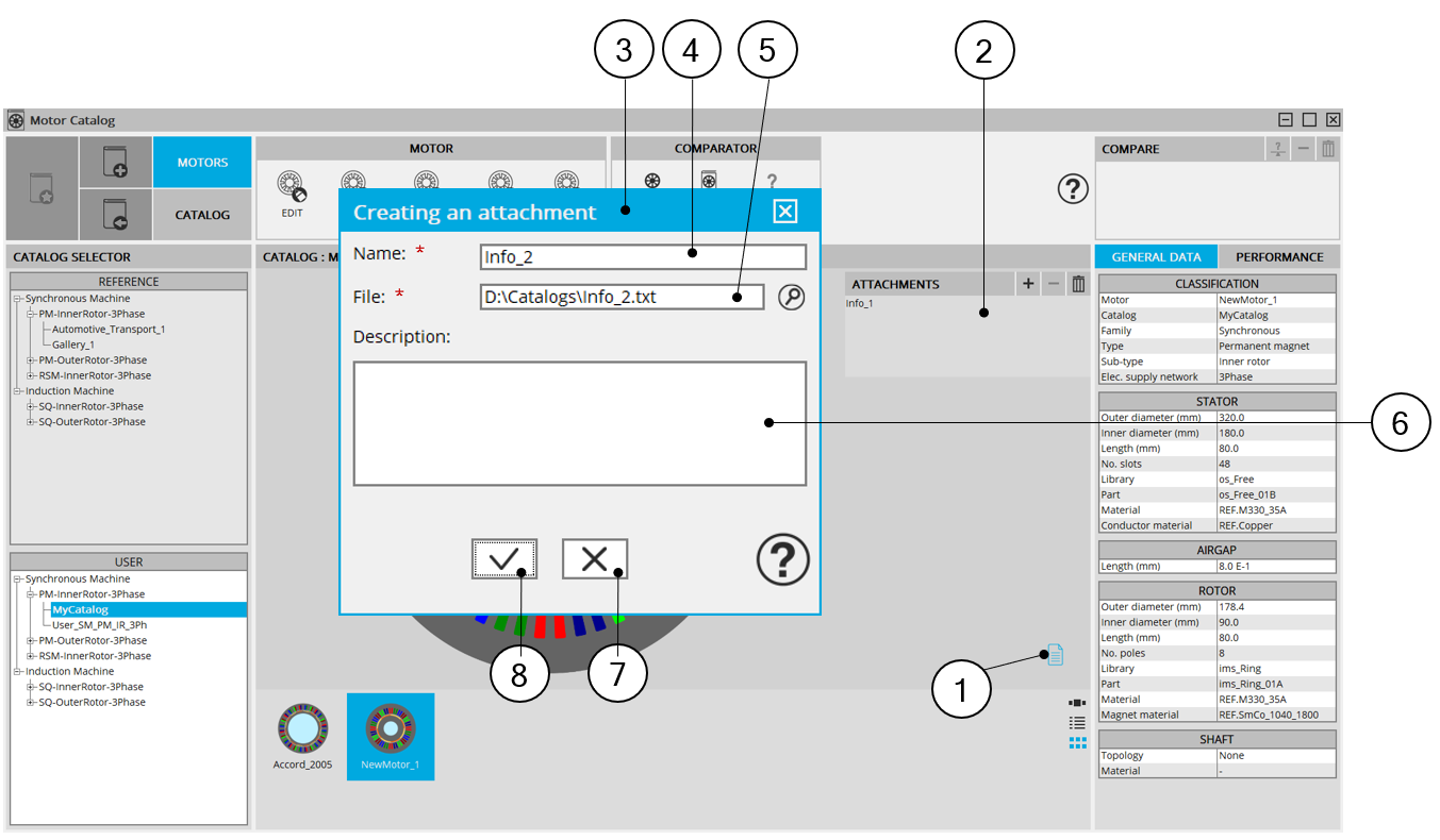

2. How to create an attachment?
| Creation of an attachment for a motor | |
| 1 | Icon to display the attachment box just above (2). |
| 2 | Attachments box to manage the attached documents.Button (+) allows
adding documents. Button (-) allows removing selected documents. Note: This box is disabled when motors from reference
catalogs are considered.
| 3 | A dedicated dialog box allows adding a new attached document. All kind of documents can be attached (like word, excel, pdf or text files, pictures, etc.). |
| 4 | Give a name to the attached document. |
| 5 | Select the folder in which the document to be attached is stored. |
| 6 | It is possible to write a reminder dealing with the attached document. |
| 7 | Button to cancel the creation of the attachment. |
| 8 | Button to apply inputs, create the new attachment and close the dialog box. |

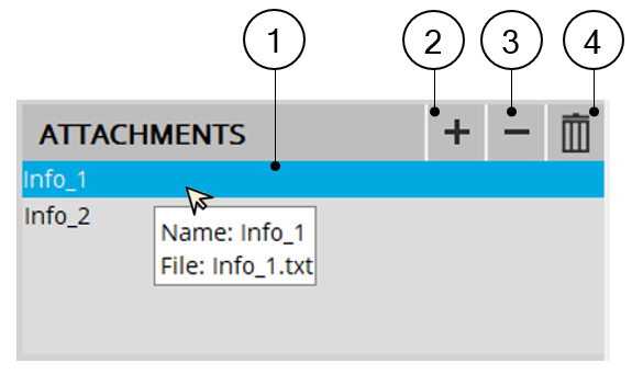

3. Management of attachments
| Management of attachments | |
| 1 | Selection of an attached document. Once selected, a tooltip reminds the name and the description of the selected document. |
| 2 | Button (+) to add an attachment (see the previous section). |
| 3 | Button (-) to remove one or several attachments. |
| 4 | Button for removing selected attached file. |
