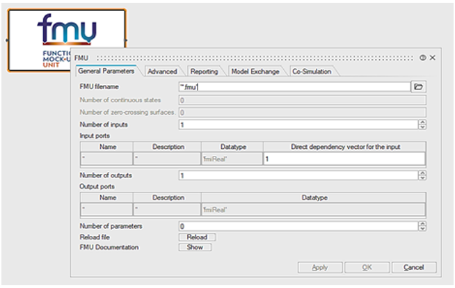

4. Select theFMUblock, then drag and drop it into the modeling window.
You could also, write down “FMU” in the quick search field.
5. Double-clickon the FMU dragged in the modeling window, or right-click, and from the context menu, select Parameters.
Then:

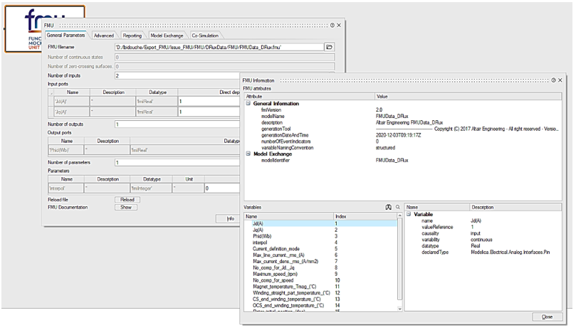

- In General parameters > FMU filename, indicates the path to the D-axis flux FMU (the directory in which the FMU file is located).
- All the information regarding the D-axis flux FMU appears along with a new content under the name parameters appears.
In this area, you can set the boundaries of the quadrant by choosing a value from 0 to 3.
These boundaries reflect the FMU response when you are outside the quadrant in which the calculations were made.
The meaning of each value is listed in the table that follows:
| Value | Meaning |
| 0 | NAN |
| 1 | Zero |
| 2 | Hold |
| 3 | Linear extrapolation |
All the information related to the resolution of the test map can be seen by clicking on the info tab.
The FMU generated will have its inputs and output. The D-axis flux FMU in Activate will look like this:
