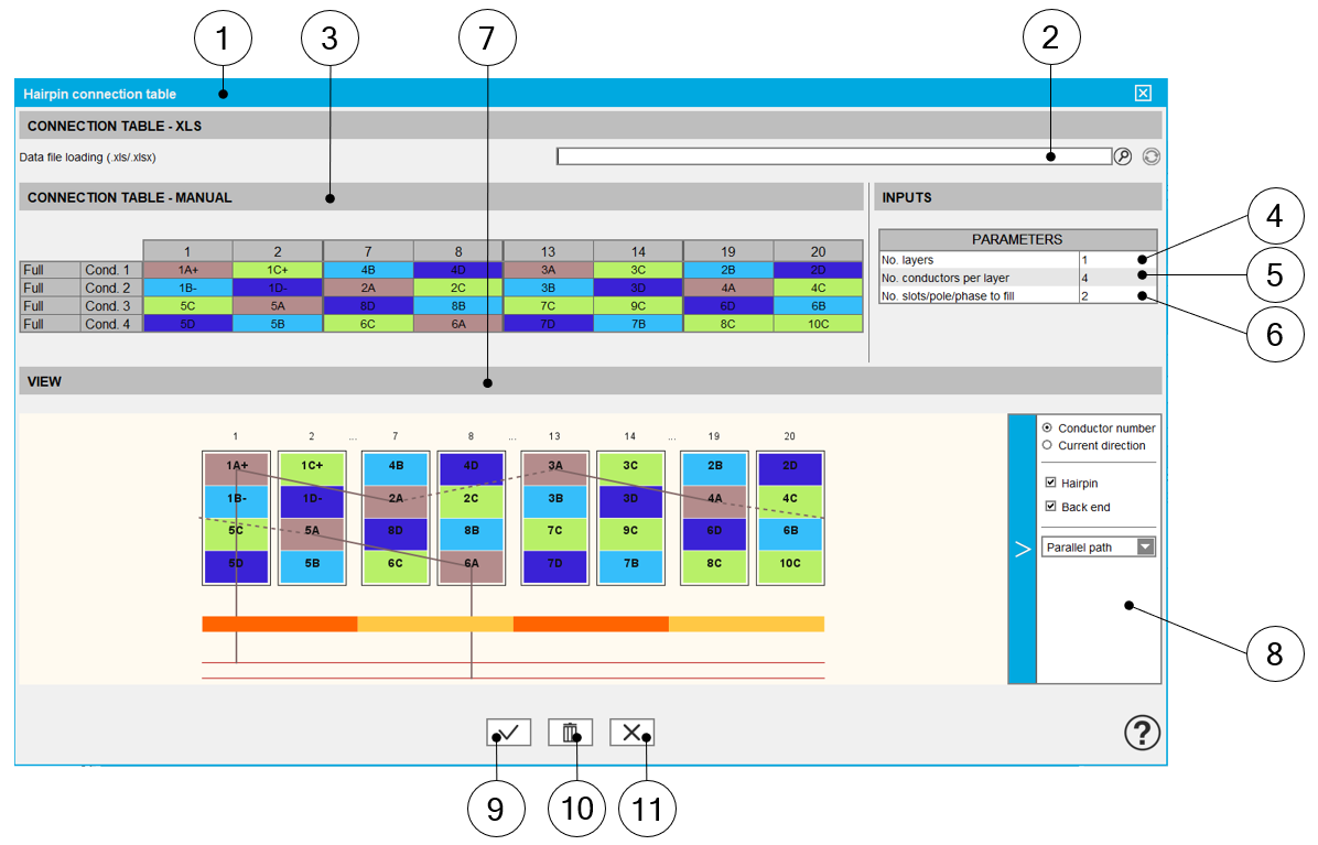

1. Expert mode dialog box
| Building the winding architecture ā Filling of the connection table | |
| 1 | Dialog box to define a connection table with expert mode. |
| 2 | Box to upload a connection table defined into a *.xlsx file. |
| 3 | Box to manually fill a connection table or modify an uploaded one from a *.xlsx file. |
| 4 | Selection of the number of layers. Number of layers are limited to 2 |
| 5 | Number of conductors per layer (This value must be even) |
| 6 | Number of slots per pole and per phase to set. No more than 2 times the number of slots per pole and per phase |
| 7 | Dynamic view of the hairpin winding updated in real time in function of the filling status of the connection table. |
| 8 |
Area to customize the view. For each elementary coil set in parallel (A,B,Cā¦):
| 9 | Icon to apply inputs and close the panel. |
| 10 | Icon to remove everything in the connection table (Erase connection table data). |
