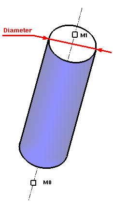

Cylinder
M0M1 defines the cylinder axis:
• | Enter the X, Y and Z coordinates to define M0. |
• | Enter the X, Y and Z coordinates to define M1. |
• | Enter the cylinder diameter. |
